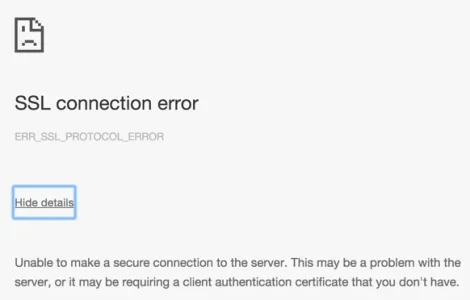

I'm getting this error when trying to access your site.
That is odd. First time I have heard of that error displaying. I get no errors at all!
