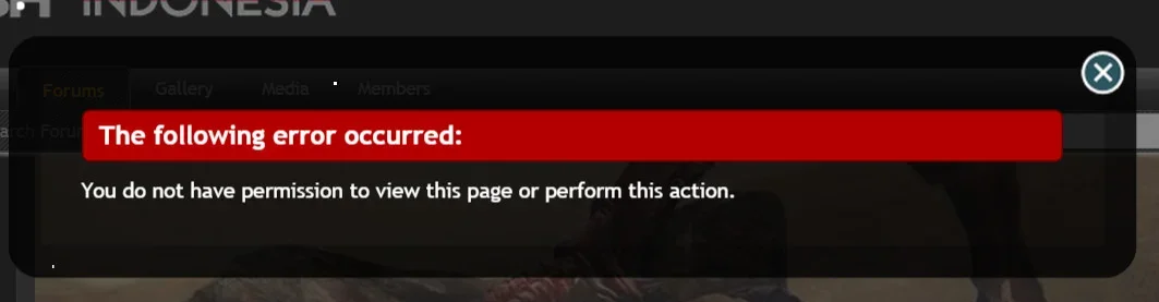

I just today realized that when I'm trying to make conversation to a member, it shows error:
What could be wrong? I have confirmed to the member that he has permission in privacy option.

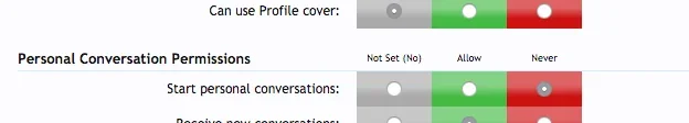

Think I found the problem (one amongst several).
You had a secondary group membership for the user you sent me of Newly_registered. In that group you had this set
As you can see... you set Never... which over-rode all other settings. I removed you from that group and it should work now (further, I set the group to use the Not Set (No) setting).
Additionally, you did not have the account assigned with the normal Registered as primary and using the secondary for all other groups (which is something I mentioned in an earlier post). That also has been fixed for that account. You need to review @Brogan's most excellent resource on implementing permissions in XenForo then make adjustments to your current setup to work within the suggested guidelines.
