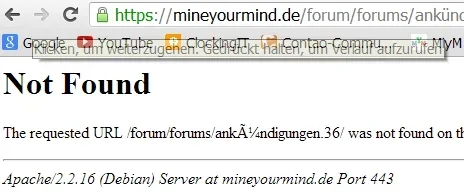

Do you have a proper .htaccess file? It looks as if you don't have it set up on your server to allow friendly URLs to function.
 RewriteEngine On
RewriteCond %{HTTPS} !=on
RewriteRule ^.*$ https://%{SERVER_NAME}%{REQUEST_URI} [R,L]

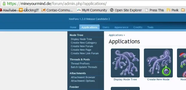

<IfModule mod_rewrite.c>
    RewriteEngine On
    #    If you are having problems with the rewrite rules, remove the "#" from the
    #    line that begins "RewriteBase" below. You will also have to change the path
    #    of the rewrite to reflect the path to your XenForo installation.
    #RewriteBase /xenforo
    #    This line may be needed to enable WebDAV editing with PHP as a CGI.
    #RewriteRule .* - [E=HTTP_AUTHORIZATION:%{HTTP:Authorization}]
    RewriteCond %{REQUEST_FILENAME} -f [OR]
    RewriteCond %{REQUEST_FILENAME} -l [OR]
    RewriteCond %{REQUEST_FILENAME} -d
    RewriteRule ^.*$ - [NC,L]
    RewriteRule ^(data/|js/|styles/|install/|favicon\.ico|crossdomain\.xml|robots\.txt) - [NC,L]
    RewriteRule ^.*$ index.php [NC,L]
</IfModule>

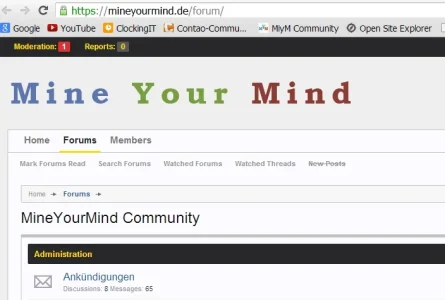

Your SSL setup is not proper:
https://mineyourmind.de/forum/
https://www.mineyourmind.de/forum/ !!
SSL Labs:
https://www.ssllabs.com/ssltest/analyze.html?d=https://mineyourmind.de/forum/&hideResults=on
https://www.ssllabs.com/ssltest/analyze.html?d=mineyourmind.de&s=94.249.198.99&hideResults=on
You're vulnerable to BEAST attacks and have no support for TLS 1.2.
