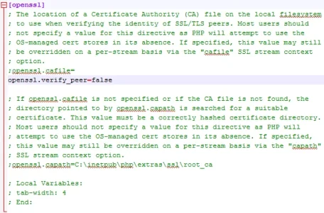

I have the openssl extension uncommented from my php.ini file and my extensions directory is defined properly. Any help would be greatly appreciated.

I am not extremely adept in web hosting, I basically know "enough to be dangerous." Should I just define openssl.verify_peer as "false" in PHP.INI?

I set openssl.verify_peer = false in php.ini. I'm still having the issue. Do I need quotes around false? Or do you think that's not the problem?
Can you confirm the active value in your phpinfo? Visit admin.php?tools/phpinfo
If it's not working then I can take a look if you give me RDP access. But if your intention is to not verify certificates then you might consider just downgrading to PHP 5.5 which has verification disabled by default. Basically download and install PHP 5.5 and change your PHP handler in IIS.
