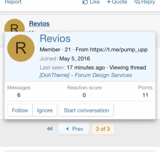

I have three very large forums and have had hundreds of these in the past week or so... Most from dormant accounts.

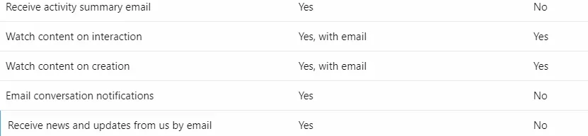

we see the same posts here but something is odd. They all show up in User Change Log with this settings changed:
but "last login" is still from long ago. Server logs show a normal login.
Some have the Moldovian IP posted above but others show up as "No IP logs were found for the requested user."
Maybe trying to hide their tracks, so the account owner isn't notified.
Really odd if the login date isn't being moved, though.
The last activity column is updated on a delay in the hourly rebuild cron, which may explain the last login date there (depending on where the date is pulled from).
I'd say this is not odd at all:
Let's assume those accounts are compromised because the attacker got an email address and a password that works to log into that email account (and other websites like forums where the same password was used) and that the user was not actively using those forum accounts (for a long time).
If that is the case, the attacker would not want the victim to become aware that the email account is compromised (due to forum notification emails) - so all email notifications are being turned off.
the last login issue is not a general one but seems to affect some these accounts. The hourly cron runs fine manually, I see other (active) accounts are updated with todays date. Same for IP.
Maybe a local issue, not sure.
sure, I meant the last login and IP problem, sorry
