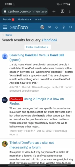

I have a big issue when I search with enhanced search, it can't detect HandBall results whenever I search with a space in between.
So I want to find "HandBall."
I search "Hand Ball" with a space instead. This search query results with nothing when I want it to show HandBall.
Any idea how to fix this?

Ah well I guess if you're talking about the technical side of things. But in practicality, it does give results for handball "indirectly" by pushing results for any words that have a prefix of "hand."
No, that's not what is happening either. XenForo is only highlighting the word hand as a prefix to the word "handball". That's not why it's coming up in the search results, though. It's showing up because the words "hand" and/or "ball" are elsewhere in the post. Notice how neither his test thread or my test thread are showing up in the search results for "hand ball" but are both showing up in the search results for "handball". That's because they only use the word "handball" and not "hand" and/or "ball" separately.

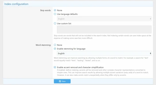

Hi Brogan,
It's wierd since I'm pretty sure I have that enabled.

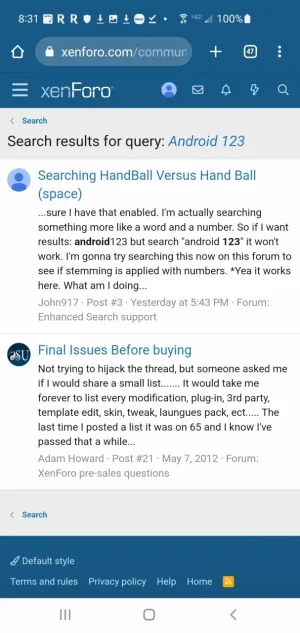

I'm actually searching something more like a word and a number. So if I want results: android123 but search "android 123" it won't work. I'm gonna try searching this now on this forum to see if stemming is applied with numbers.
*Yea it works here. What am I doing wrong...

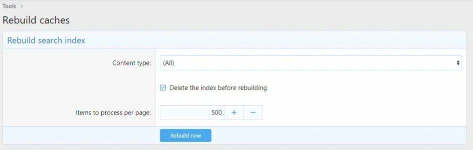

Changing index configuration options requires a full reindex, and depending it may require truncating the data which actually deletes the index and then recreates it.
Sadly this can be different from just updating the index because ElasticSearch is a little janky at times.
Yea, are you referring to the option to delete search index when recreating it in ACP?
Or im assuming full reindex is done on the elastic search server?

By the way, stemming does work with numbers so its gotta be something else (attached)
He's talking about rebuilding your search index, in the ACP, as seen here:
From what I'm seeing, your search for "android 123" didn't return a result for "android123". It returned results for "android" and "123" separately. Notice that "android123" isn't all highlighted (or bold) in your search result.

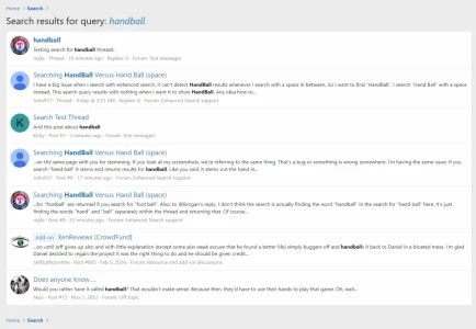

I've created a little test thread that has two posts (one with handball and another one with hand ball) to demonstrate this.
Searching for hand ball
Searching for handball
As can be seen from the sreenshots, only one of those posts is returned in either search.
The screenshot posted by @Brogan might lead to the assumption that handball was matched in the first post (as hand is highlighted as part of handball), but this actually isn't the case (only hand ball was matched in title and message):
Highlighting is done in XenForo (with a rather simple approach) while matching is done in ElasticSearch; to get accurate highlighting it would be ncecessary to also do highlighting in ElasticSearch.
The real fix for this usecase (apart from the highlighting) would be support for synonyms and decompounder as handball is basically a compound word made of hand and ball
