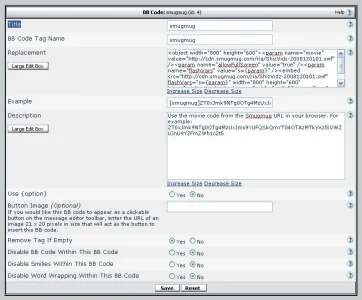

Here is how things are setup in vb3.8, and it works splendidly. Lets say someone wanted to post this sample video, as an embedded video on my vb3.8 forum:
http://vincentlaforet.smugmug.com/gallery/6042742_wZKiA#377930419_dgxvY
They would go to that url, click on 'share' in the upper right hand corner, 'get a link', embeddable links tab in the popup, click on the 'Copy' to the right of the iPod/DVD tab, then past into a post. Here is the code for reference:
Then delete everything except one of the 2 ids starting with the "s= up until the next quote. Which for that sample video would be this code:
ZT0xJmk9Mzc3OTMwNDE5Jms9ZGd4dlkmYT02MDQyNzQyX3daS2lBJnU9dmluY2VudGxhZm9yZXQ=
Then they would wrap smugmug tags around it like this, and it shows up beautifully as an embedded video:
[smugmug]ZT0xJmk9Mzc3OTMwNDE5Jms9ZGd4dlkmYT02MDQyNzQyX3daS2lBJnU9dmluY2VudGxhZm9yZXQ=[/smugmug]
Here is the BB Code manager in the vb3.8 admin control panel
Here is the code in the Replacement box:
Here is the Example:
[smugmug]ZT0xJmk9NTg0OTg4MzUxJms9YUFQSkQmYT04OTAzMTkyXzlSVWZUJnU9Y2FmZWh1c2t5[/smugmug]
(I removed the code tags because that was inserting an extra space for some reason)
Here is the code from the description box:

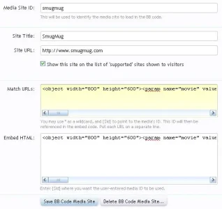

Obviously the goal is to get embedded video in xf, not vb. This is what I have at the time being, which of course does not work, or there would be no need for this thread..
In the matching URLs this is what I have now:
And this is in the Embed HTML, which is the same as the matching URLs code:
I am well aware that embedding smugmug is horribly convoluted and not very friendly. But there are historical reasons for using smugmug.
<object width="800" height="600"><param name="movie" value="http://cdn.smugmug.com/ria/ShizVidz-2008120101.swf" /><param name="allowFullScreen" value="true" /><param name="flashVars" value="s={param}" /><embed src="http://cdn.smugmug.com/ria/ShizVidz-2008120101.swf" flashVars="s={param}" width="800" height="600" type="application/x-shockwave-flash" allowFullScreen="true"></embed></object>
Use the movie code from the Smugmug URL in your browser. For example: ZT0xJmk9NTg0OTg4MzUxJms9YUFQSkQmYT04OTAzMTkyXzlSVWZUJnU9Y2FmZWh1c2t5
<object width="800" height="600"><param name="movie" value="http://cdn.smugmug.com/ria/ShizVidz-2008120101.swf" /><param name="allowFullScreen" value="true" /><param name="flashVars" value="s={$id}" /><embed src="http://cdn.smugmug.com/ria/ShizVidz-2008120101.swf" flashVars="s={$id}" width="800" height="600" type="application/x-shockwave-flash" allowFullScreen="true"></embed></object>
