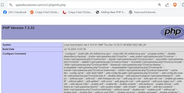

my phpinfo
I thought maybe nuking or renaming the add-on folder might help ???
That means php isn't running.
Find a new host if they don't know that.
Find a new host anyway if they upgraded the OS and PHP without informing you.

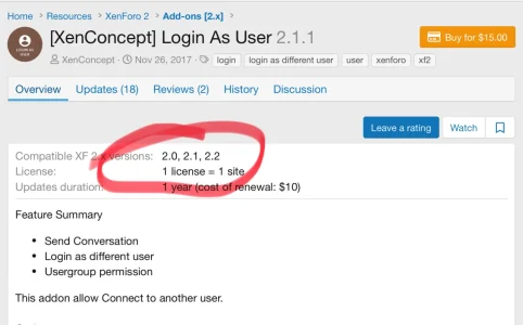

Weirdness...
Thank you for your reply
I'm not sure what you are pointing out but, I am using 2.2.... and have been using that logon as user app for years. All of this weirdness happened when the dang host changed the opsys and the php version. The host kept telling me it was an add-on but could not (or would not) tell me which one. Even disabling all add-ons via the config.php did not help. I ended up nuking the add-on folder (by renaming it) and then, I was able to access the site and view the error logs. Disabling add-ons via config.php did not disable the Logon as User add-on... it still ran and prevented the site from coming up.
