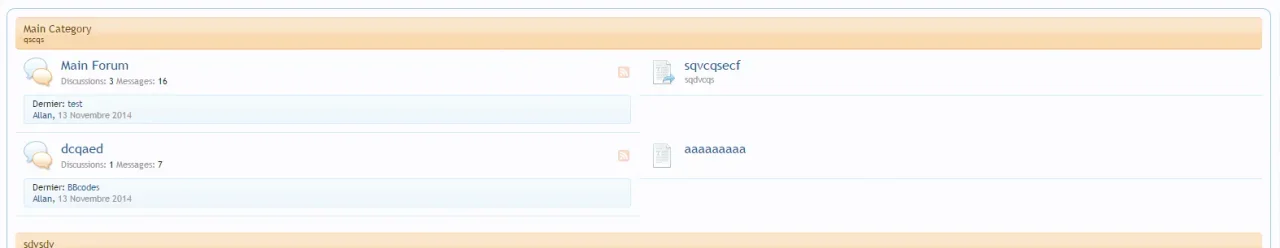

Hi Mike, i have little problem with page and link node, they are not at the same level as the forums :
An idea ?
There are some options. our method is rather complicated. It essentially fakes borders so it looks like a table and you don't notice the height issue. @Allan

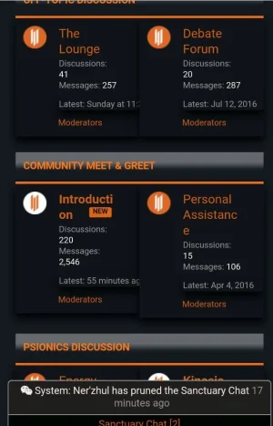

How do I fix the bunched up look on mobile? I reverted it back to it's original look but I'd really like to use this on my site, but it looks weird for mobile while it looks perfect for pc.
Is the guy still around? and if not does anyone else know? I really need to figure out a way to fix this.

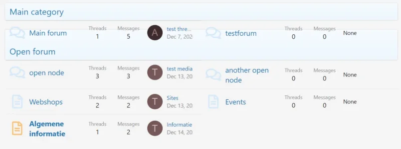

Hi all,
I would like to create a grid view of the nodes with two columns for XF 2.2
I know there are theme's or add-ons with this function, but I would like to learn the XF code. :)
As guideline I use this resource and with searching the forums and with help from the inspecting elements tool I updated the divs to XF2.2.
However, just updating the divs to XF 2.2 style does not really work.
This code reverts all the changes to default, so I did not use it.
{xen:helper clearfix, '.block-body'}
the code I have at the moment (extra.less):
CSS:
.block-body .node--depth2 {float: left; width: 50%;}
.block-body .node--forum, .block-body .node--link, .block-body .node--page {float: left; width: 50%;}

I get two columns. However, it does not really look how it should. See the attached screenshot.
Did I miss something or does XF2.2 require another method to achieve this?
Thanks in advance for any help.
