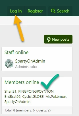

As you can see this session there is nobody logged in and the member list can be viewed
Thank you again @Bespoke for that insight!
