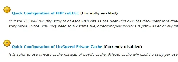

Alright, looking at my WHM settings, under Service Configuration -> PHP and SuEXEC, I have the following settings
Under Litespeed Web Server Configuration:
I haven't seen any LSPHP references, but this is my first time working with LiteSpeed and I'm just sorta over my head. (Thanks for all of your help! I truly appreciate it)
The first screen shot doesn't have any relation to Litespeed. This is Apache configurations and you don't care for them (unless you run Apache, but you have Litespeed, so you probably don't).
The second print screen is Litespeed's control panel in WHM. Go to PHP SuEXEC PHP configuration and disable it.

So, I disabled suEXEC and got into the litespeed control panel. Real-time stats shows lsphp5.
