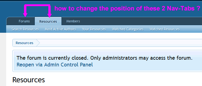

I would like to put the RM at the Homepage.
I have changed the "Index Page Route" towards resources/
This is working fine.
Question:
How do I change the position of the Nav-items, so that "Resources"-Tab is at the left position, and the "Forums"-Tab is at the right-hand-side of the "Resources"-Tab ?
Many thanks!

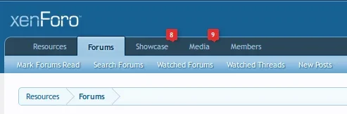

I actually saw this implemented at www.xenzine.com and thought I could do the same by just putting the "Resource Manager" as the "Home"-Tab with some simple clicks.

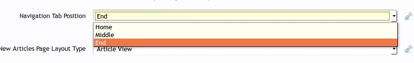

Several addons are starting to include an option for this. I've added an option to most of mine. I nicked the idea from @Chris D & XFMG :)
