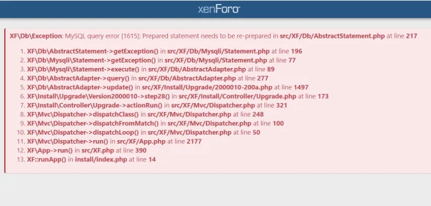

So, I was going to do my live upgrade from 1.5 to 2.1 tomorrow. However, we have started getting the errors described in this and various other thread (Prepared statement needs to be re-prepared). We are in shared hosting so restarting mysqld or messing my.cnf ain't happening (already contacted the host).
So, do I pull the trigger and see if upgrading fixes it? Or do I keep plugging away at this and push off the upgrade? My worry as an old school IT guy is that I won't know if any errors I get post-upgrade are due to this or the upgrade.

Disable all addons and see if the errors continue, one or more of them may have PHP compatibility issues.
Thanks, Ozzy. Yeah, that one was on my radar for today. I have to remove all of them before the upgrade anyhow so if disabling them fixes it, then I'm good to go. They are fairly old add-ons, too. None of them are coming back after the upgrade. Two are no longer needed and the third is being replaced with a newer, more capable add-on.
Definitely getting fewer of them but I did get some happening while I was doing some cleanup in ACP to accommodate for losing the add-ons. It does seem to be related to them, though, so I may just go ahead with the upgrade since that gets rid of them completely. But, I won't have time until afternoon (EST).
And the correct answer to my subject line is "No". The error comes up during the install process bringing it to a grinding halt. Currently restoring to 1.5 from my pre-upgrade backup and figuring out next steps. Any thoughts on how to take it from here?

Okay, I tried my dev (should have done it earlier) which is running 2.1.0 and it's affected, too, which pushes it back to our host.
