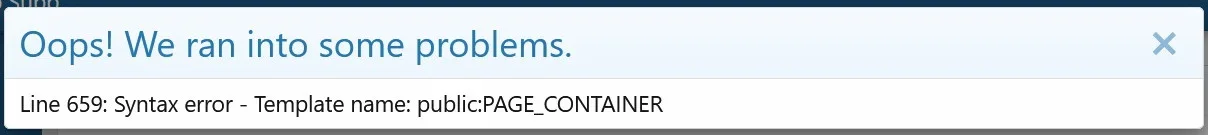

XenForo tips & guides [2.x] Scroll down button to a position higher than the footer gives a strange problem.
Even If I alter one item in PAGE_CONTAINER en I will save it, then a fault message comes up:
What is the problem, I don't know.

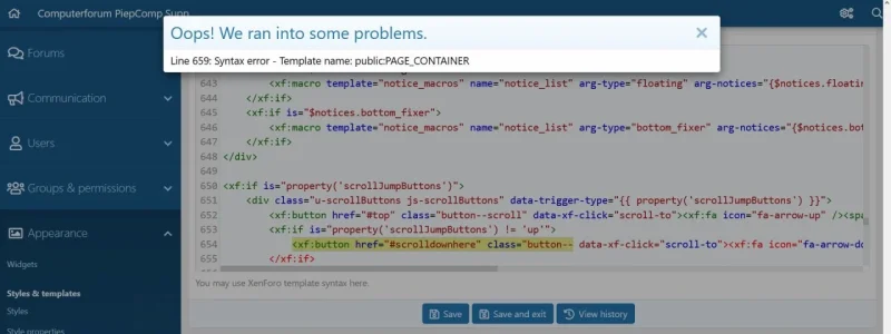

Hello Mr. Lucky, I altered exactly conform what you wrote to do in PAGE_CONTAINER
I just tested it and it works fine.
You need to post what you did in order for anyone here to diagnose what you did that would cause the error, because without that it's impossible to say what the issue is.
Hello Mr. Lucky, i took what longer.
See picture:
CSS:
<xf:macro template="helper_js_global" name="body" arg-app="public" arg-jsState="{$jsState}" />
Yes, looks like you missed some stuff after the replacement noted in the instructions. You need to follow exactly what it says or you will get error.
Would have the first notation also been in a codeblock just like the second notation, I would not have missed scroll"
