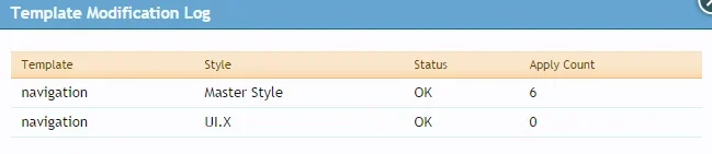

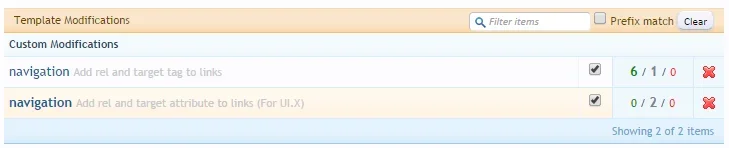

Here is what it's showing me on the template modifications page:
This is for the default one:
And the UI.X one:
I cannot figure out why the apply count is at zero.. I haven't done much using the template modifications, so it is probably just something stupid I have missed.
It is showing zero because you're searching for something that doesn't exist in the master style, in your second modification. Modifications are not style based so you can't search for a modified line from another style.
