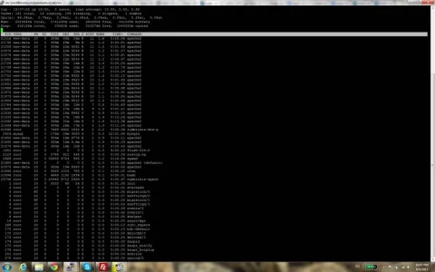

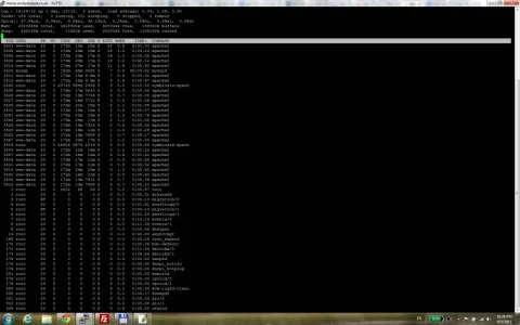

@Daniel 'RTRD' , I had a huge load on my serever with this mod on in case of cpu usage and load average. I have about 700 users peak online with about 11000 in total on forum. The interesting thing is that load doesn't drop if I turn it off. I'm using APC opcode and I can say load even higher when it's off with about 20 load average on peak time. Here is other examples with APC on and status ribbon off and on:
So how do you know that this mod is responsible for the high load if you still get high load with this mod off? I don't understand.
@Dakis, Please, look at load average in attached files, especially the first values. As for cpu usage which you could see in the first file I can say that usually it not so high and the highest I've seen.

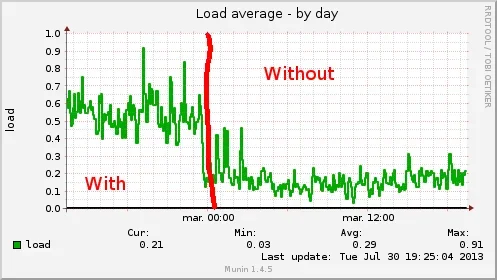

Online Status Ribbon Activated:
Online Status Ribbon Dectivated:
