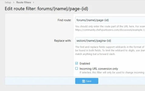

Don't know if you found a solution after so long, but I just wanted to share that a finally solved it after a long time struggling.
I got it almost by mistake, thanks to this reply from @Chris D, which is even older than this thread (2014).
Actually I only have one forum with multiple pages, which contains a lot of threads as my community is still under construction, so there's no one posting/replying within threads at the moment. But I assume the same way will work for thread's pages, just by modifying the code accordingly.
I've found that the systems accept {name} and {id} tags, so for this forum section I've set my filters like this:

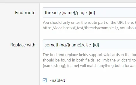

So for thread pages I assume it will be threads/{name}.{id}/page-{id} and then your custom replacement.
Hope this will help someone that would have our same needs in the future, avoiding struggling around like I did for a very long time.
Cheers! 👋 :)

Your solution works for forum pages, but the solution for threads doesn't work unfortunately.
Maybe @Brogan can help in this case?
