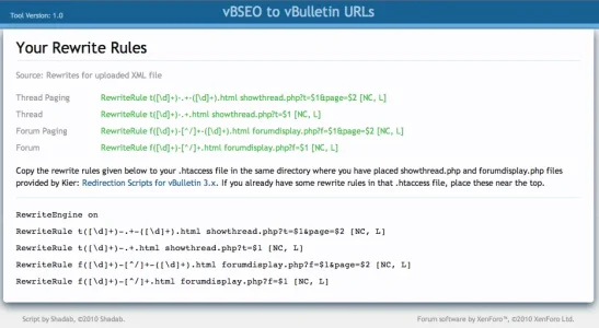

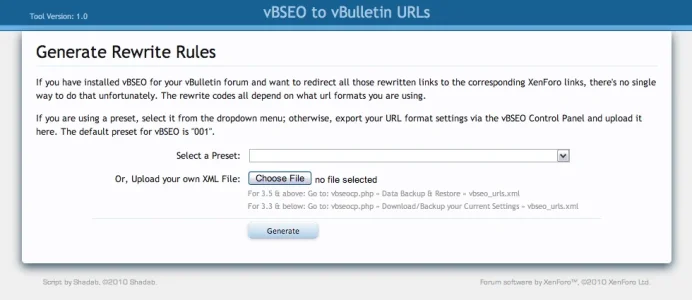

I've uploaded the script at: http://tools.geekpoint.net/xfseo/, with the ability to upload your own XML backup file and have the tool generate rewrite/redirect rules for you (in case you are not using a preset). Let me know if you encounter any errors while using the rewrite rules or the script itself.

@Voyager-S.: Sure! And in case you are using a custom url format for showthread or forumdisplay pages, you can upload your xml backup file here.

Yes, I'll release it. Although I'll host the tool on my domain as well, so it would be as simple as uploading your xml file and copy-pasting the output generated.

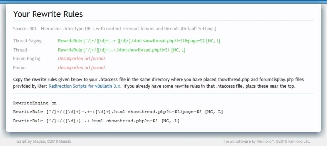

I've made a few customizations that I'm regretting :( so it's 500 internal server errors for me without it all(?).
RewriteEngine on
RewriteRule [^/]+/([\d]+)-.+-([\d]+).html showthread.php?t=$1&page=$2 [NC, L]
RewriteRule [^/]+/([\d]+)-.+.html showthread.php?t=$1 [NC, L]
<IfModule mod_rewrite.c>
	RewriteEngine On
        RewriteCond %{REQUEST_FILENAME} -f [OR]
	RewriteCond %{REQUEST_FILENAME} -l [OR]
	RewriteCond %{REQUEST_FILENAME} -d
	RewriteRule ^.*$ - [NC,L]
	RewriteRule ^(data|js|styles|install) - [NC,L]
	RewriteRule ^.*$ index.php [NC,L]
</IfModule>

UPDATE 2:
Replaced all instances of [NC, L] with [NC,L] in the first post.
And updated the script accordingly, as well.
That extra whitespace after the comma was causing apache to go crazy. :oops:
