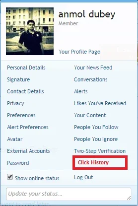

Requirement 1: Add a tab or menu item in user menu - Something similar to below

When the user clicks on above menu item he should be displayed all his click information by firing a select query to external database
