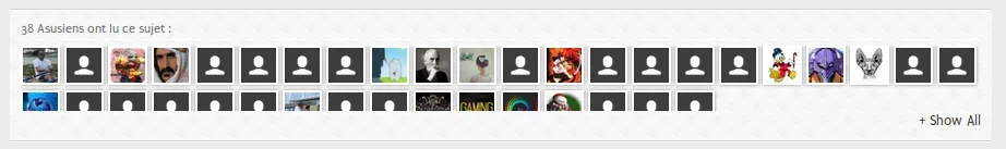

Hi @rainmotorsports ,
thank you for this mod.
How can i change the height of the block so that the second line of avatar is well displayed : ?

Hey there, am having the same problem where it's cutting off the bottom of the avatar on Thread Viewed By, have adjusted the avatar height to 20 x 20. Increasing the container height just makes it bigger, still cuts off the bottom of the avatar. The people viewing this thread container is fine.
Hi, partially solved the problem by increasing the value in option field : Container Height Limit (set to 85 here)

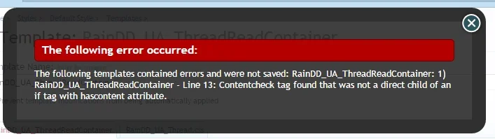

I tried to remove this "if statement":
    <xen:if hascontent="true"> </xen:if>
but I cannot save the template, I got this error:
