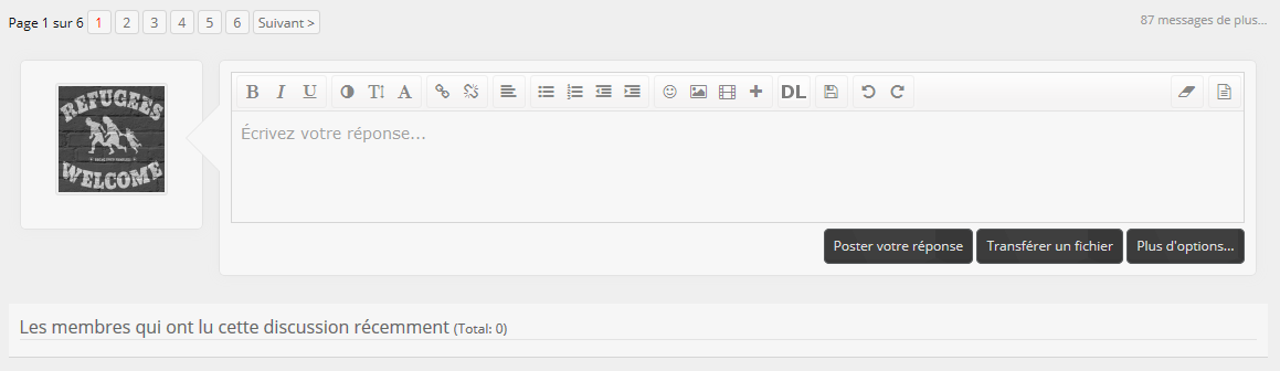

There's a bug, after migrating from vBulletin to XenForo 1.5, all of the threads that were posted in vBulletin are not working with your addon. It will always say zero members has viewed this topic.
The topic posted after XenForo migration will work fine
If you can't fix it, then a quick workaround could be to not display anything at all when zero member has viewed the topic, but i don't know how.
I used XenForo importer. Tried rebuilding thread cache too. Even after importing, when a member views a thread that was posted before the migration, his member name won't be added to the "member who viewed the thread" and the counter always stay stuck at zero

Ok, but even the new views aren't counted in the old topics... That's not normal

If the bug can't be fixed then i need a way to prevent displaying the "who read thread" box when the counter is stuck at zero...

Then maybe @rainmotorsports should consider adding a line of code to hide the "who viewed this thread" box when there are zero users who read the thread, due to the "bug"
It would avoid tens of thousands of threads with pages of replies to display "zero users read this thread" everywhere on my forums, like this: https://www.libertaire.net/discussion/le-probleme-de-la-surpopulation-humaine.9581/
UPDATE: It was actually somewhat designed to hide itself when there were no data of users who have read the thread. There was a "if hascontent" check in the template. But, it was kinda badly written, so the check would end up returning true regardless of whether there were any users who have read the thread or not. If you want a simple fix that would hide the Users Who Have Read block when it couldn't get any data, then edit RainDD_UA_ThreadReadContainer template, and replace the whole content with these:
