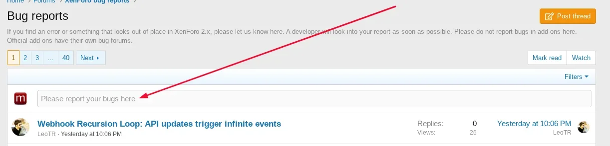

I just double checked it is the forum_list template I want to add the entire quick reply to and to direct it to forum #2
Reason
The site has no forum_index visible, only forum_list which mixed together the threads of two forums.
Therefore there is no quick thread on that template but I wish to add it directing the quick thread to forum #2.
This NEW site is quite unusual
No Index page
No buttons
It strips out a lot of forum looking stuff and consists of one page forum_list only and because there is no NEW THREAD button I want Quick Thread only but to direct to forum 2 because the only other forum needs special permission to post.
So basically the forum_list template shows the thread of two forums but I need a quick reply to be added directing it to post into a specific forum.
That quick reply under address.com/forums (default installation)
When inspected my index template shows like this... (notice I am using forum_list as my main index page)
So technically it does sit under the page_container but the code has to resolve to the top of the thread list at forum_list
