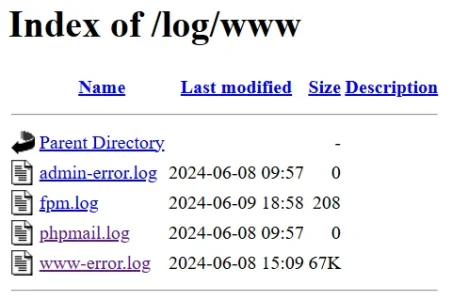

Where can i find them?
My PHP log is empty concerning mailing
You'll need to check your PHP configuration settings to know whether and where it's logging inbuilt mail functionality.
phpmail.log in your screenshot looks obvious, so perhaps it's not logging or you have no issues to log.
If no issues to log, then you next to check next step configuration to see how/where php inbuilt mail is sending your mails for delivery.
