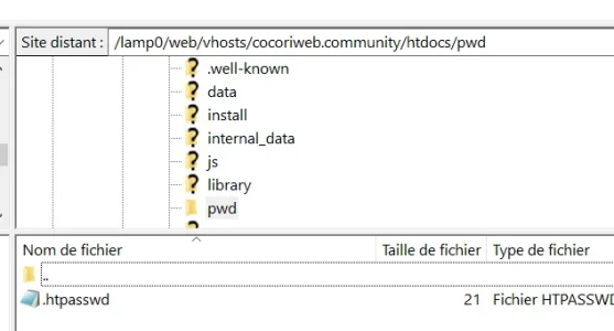

[Mon Feb 01 16:24:26.898792 2021] [authn_file:error] [pid 105270:tid 139733648557824] (2)No such file or directory: [client 41.214.91.37:51466] AH01620: Could not open password file: /lamp0/web/vhosts/cocoriweb.community/htdocs/pwd/.htpasswd
Why server can't open the password file ? The path seems to be good
If the file is physically present in the file system, then it could be a permissions issue, SELinux, or something else server side.
Is it? So you only used xyz to mask then?
AuthUserFile /lamp0/web/vhosts/cocoriweb.community/htdocs/xyz/.htpasswd
Finally i read my host doc and i have to put the file here /lamp0/web/vhosts/cocoriweb.community/.htpasswd
But i've got the same error...
