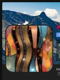

I agree, I'd like to see an option where you can keep everything seperate from overlapping
It might look okay if you have a nice abstract background. But as soon as you start putting actual photos up it starts to get messy looking and you can't appreciate the banner in full, or easily read the text, even with darkening the background and adding shadow etc.
Please add the option to instead keep everything separated like this
Part of my original suggestion, which I forgot to post was for this also to be the case for the membercard.
Have the banner on it's own as a banner above the avatar, username and user info. Not everything completely covering the banner as it is now which ends up crazy busy looking.
Or another option, at least add a border around the avatar. If you use the content background color, it makes the avatar "pop" a little better:

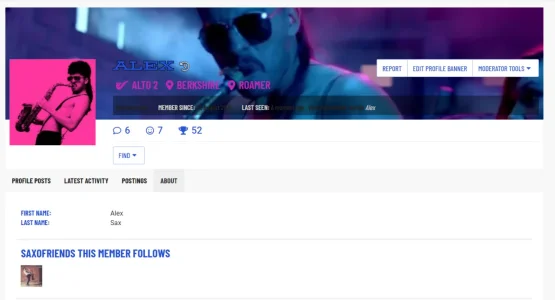

Will change this:
to this:
Nice work @RobinHood :)

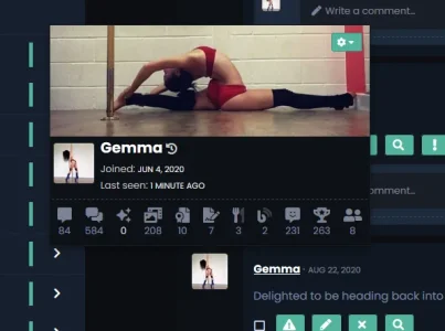

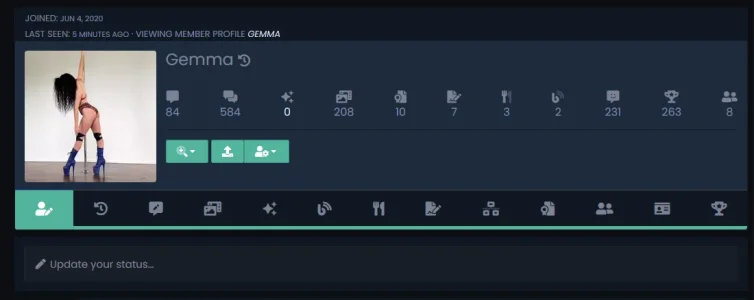

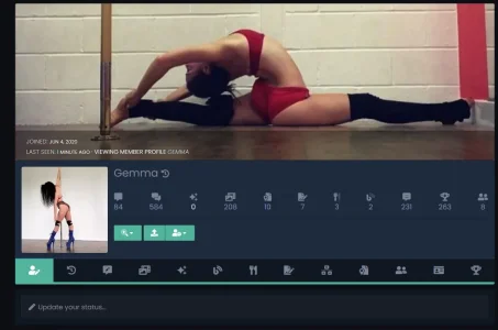

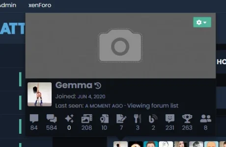

I've been using something similar, actually been using this same layout since XF 2.x when I used third-party profile "banner/header" addons.
Profile with banner
Profile without banner
Member tooltip with banner
Member tooltip without banner
The banner/header looks much cleaner and, if you have wonky eyes like me, you can actually read the text.
Thanks :)
Yeah, need to sort the tooltip next.
