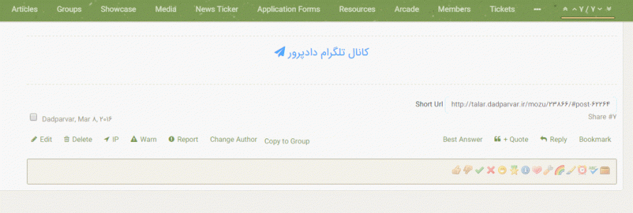

Maybe a bug.
When I rate a post, then click on the "List" and hover on ratings and click on "Delete rating" next to my own rating, then the rating will be deleted. But I can't re-rate the post until I refresh the page (the rating bar gets hidden until I refresh the page):

Maybe a bug.
