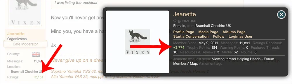

Thanks, I presume you mean this one:
However that does show the word ratings under the avatar, but the number only shows the number of likes, not the number of positive ratings as shown in the member card. What I want is for both the to show the positive ratings

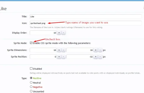

Changing the icon for each rating is a bit confusing. The file name is correct yet it just becomes an icon-less rating. Only spritesheet.png works.
Are you unchecking the spritesheet option when you're uploading your own images to replace the existing ones?
