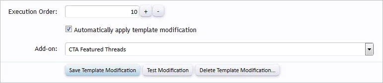

My add-on uses a template modification and injects it after the /xen:container tag, with an execution order of 10.
If the other add-on does the same, the execution order will determine which one is at the top and which is at the bottom.
Thanks Brogan. Is it an easy matter to change the execution order? For example what and where would I change it in you addon so that I can experiment?

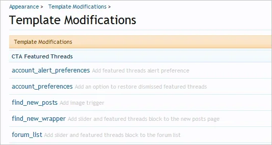

You need to enable debug mode, then click on the template modification and change the order here:

Have found template modifications but there are none for the other plugin so I guess it works differently. Changing the order for CTA Featured Threads in forum_view (Add a featured threads block to the forum view) does nothing.

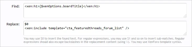

Without knowing how the other add-on does it, there's not much more I can say other than move the template edit to earlier in the template.
Try doing the find on <xen:h1>{$xenOptions.boardTitle}</xen:h1> instead.
