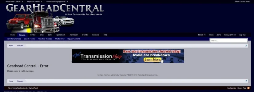

Flexin
Anyone else getting this error? I have more then a few members that have been complaining about this issue for the last week or longer. I even get it every now and then. I tried using a different style to see if that was the issue but I just got the error in that one as well.
I deleted Icewind Dale RP Total Forum Thread Views 1.1 for now because I found some errors in my server log for it. I upgraded first to see if that was it but that didn't help. I decided to uninstall and then reinstall but decided to wait on the reinstall until I check to see if it worked without it. I am still getting the error.
I think tried a different style I have installed and I still have the issue.
I'm not showing any server errors since June 5th. Any ideas on what can be causing my problems? I might let my hair grow so I can pull it out. But first I thought I would ask for help here.

What are you and the users doing before receiving the error?
Just posting. You post, get that error. Members said they have tired three times to post in a thread and recieved an error all three times.
One member did that and then had to answer the question in another thread and told me about the error there.
I tried to post 3 or more times in a thread today and it happened to me. I found a thread that mentioned that the style could be the problem. I tried a different style and posted in that thread without an issue. Tried a few more then I had the error reappear.

Is there a corresponding error message in the ACP?
In the server log? Nothing listed in over a week. Yesterday I'm sure it showed one for that day.
I did have errors in there that were related to Xenporta so I disabled it, that didn't help. I uninstalled and then installed it again. That didn't work. I upgraded and still didn't help. So I don't know if that is causing this problem or its a separate issue all together.
