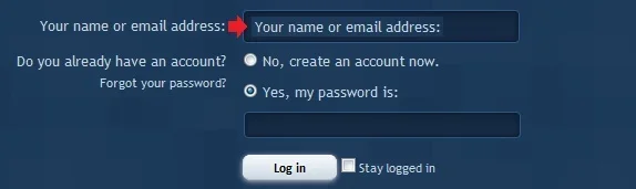

Hello. I would like to change the Placeholder´s text position for "Your name or email address:" and "Do you already have an account?" from outside the Login Slider´s textCtrl Field to inside. On active field their should be no text anymore.
Is it possible and can anyone help me with that?

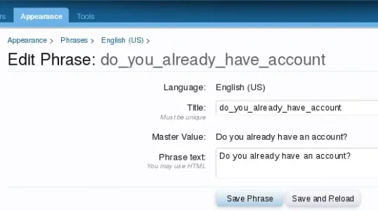

This can easily be changed by looking for these phrases templates
AdminCP > Appearance > Phrases
  • do_you_already_have_account
  • your_name_or_email_addres
But i dont want to replace the text, i want to move the Text (e.g. Your name or email address), as shown in the picture, from left to inside the name´s form field.
Sorry for any Misunderstanding, but i thought the picture helps clarifying my wish?!

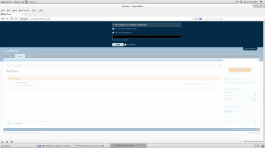

DONE :)
Screenshot from 2013-11-28 17:10:48.webp
login_bar.css
Would allow you to further customize the log-in bar to your liking. ;)
