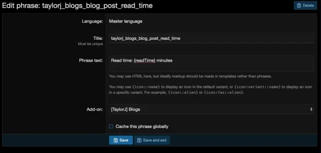

I'm currently having some issues with phrases in Javascript where it's just rendering out the name of the phrase
My javascript is below:
JavaScript:

Phrase is already created
Is there something I'm doing completely wrong here?
