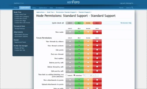

Node permissions:

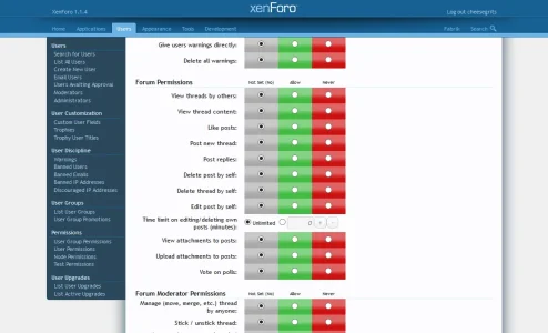

Group permissions:

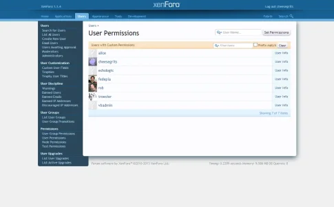

User:

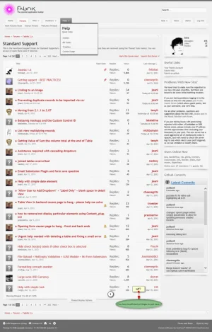

Forum view:
Any ideas?

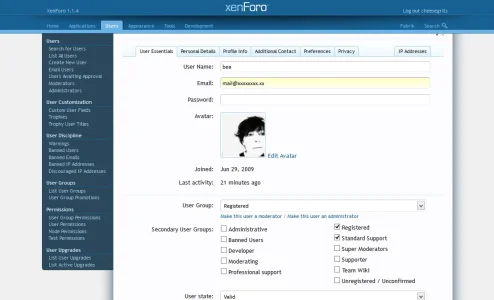

Hmmmm. Well, that would seem to be the answer. Or at least it's something to do with it. I removed the "Registered" from the Secondary groups and saved the user, and that fixed it. I don't yet know if it was the act of saving the user, or removing that secondary "Registered".
I noticed that XF itself won't let me then save it with Registered as a Secondary, in that it will always remove the Primary group from the Secondary selection. But if you look at that first shot of Bea's group settings, you'l see that Registered is both Primary and Secondary. So I'm not sure if it's because the bridge adds the Primary to the Secondary, or because the bridge doesn't trigger some kind of permissions cache rebuild.
