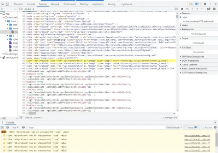

@Nulumia, I have jsut noticed that I started to get 5 warning as
<link rel=preload> has an unsupported type value
Not sure how important it is. So I want to share with you.
