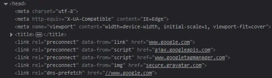

Another thing, how can we check if the preconnect is working? If I look at the page source, I don't see any preconnect directives, but maybe this is inserted on another level?
Inspect your page in your browser console, or View Page Source. Then in the head of your document, you should see a bunch of the following:
Edit: The "data-from" attribute in the preconnect tags is a hint of where the addon grabbed them from :-). Preloads also use these, and will even tell you things like "img", "script", "bg-style" 😛
This is with Preconnect Automatic Detection enabled. Honestly that part of the addon is so good, I stopped developing any sort of manual preconnect methods as it's simply unnecessary. (Except for .less template detection - but see my next reply for that!)

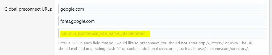

I am likely going to remove this feature completely. The automatic preconnect detection is just that good (unless there's major issues which prevent it from working). I don't see a reason to manually/global preconnect anything if the addon can detect and preconnect them only when needed.
I think this option could be useful to those running Google Ads / Adsense.
The main Google code inserted is typically just:
<script async src="https://pagead2.googlesyndication.com/pagead/js/adsbygoogle.js?client=ca-pub-XXXXXXXXX" crossorigin="anonymous"></script>
Which when run makes multiple connections to additional google domains:
1) pagead2.googlesyndication.com - 10 connections average
2) googleads.g.doubleclick.net - 6 connections average
3) tpc.googlesyndication.com - 6 connections average
...along with a few others.
I could see this setting being useful for those using Google Ads / Adsense. I don't think your add-on would pick up on these domains to preconnect to since they won't be seen till the javascript is actually run, but preconnecting to them can be very beneficial. Typically at least one ad is found above the fold and can affect multiple page metrics and influence page SEO through FCP, LCP, TTI, OT and possibly others.

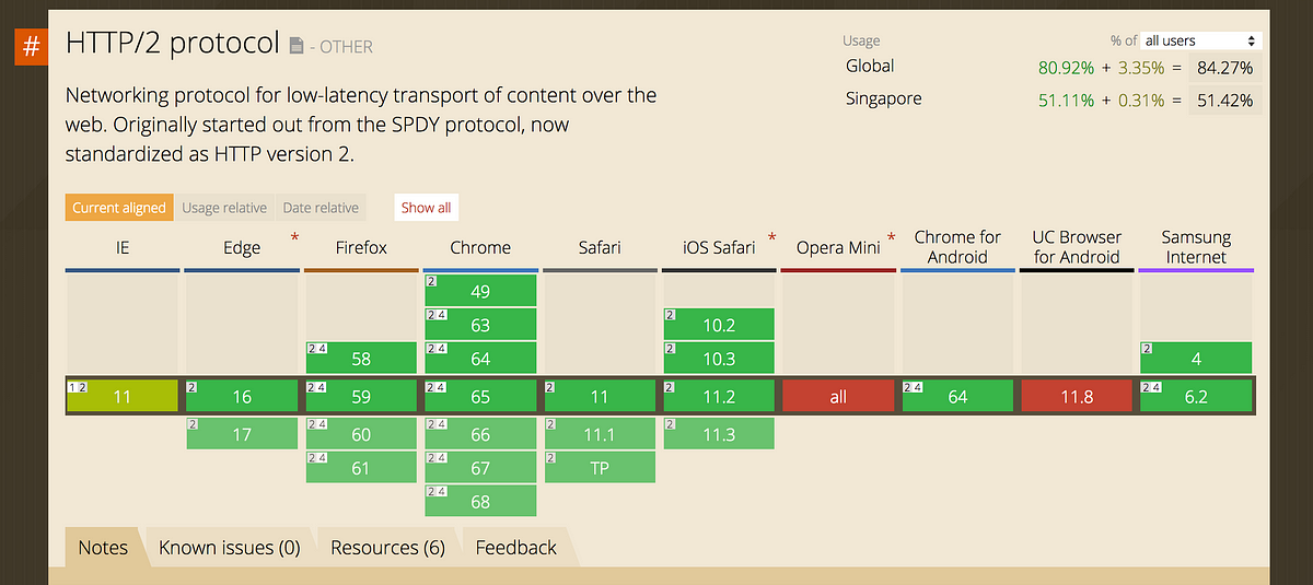

Two questions:
I'm using a subdomain for 'externalDaraUrl' and 'javaScriptUrl'. This used to be a recommendation to server data/javascript from another (sub)domain to allow more simultaneous connections.
Is this still needed/recommended when using this addon?
TL;DR Domain Sharding used to be an optimization technology primarily for HTTP/1 - use with care on HTTP/2 (in many cases don't do that at all)
