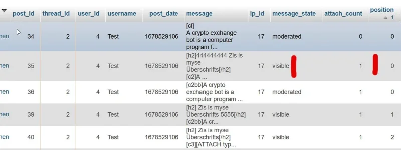

Also i have some posts with visible and post_position = 0;
I have recalced all post.positions and start from beginning, again i get posts with visible and position = 0

When i edit now post 35; state=visible; position=0; i will get the error.
