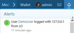

  • Alert specific users about visits from tracked countries and IP's

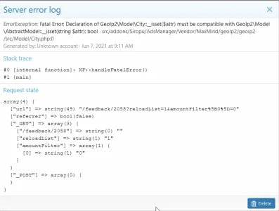

I just installed it to give it a try and it took the site down with this error (until I disabled the add-on).

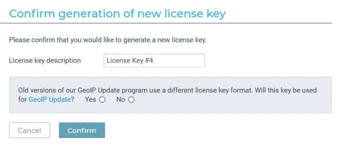

When signing up for a new MaxMind key, I selected "No" for "Will this key be used for GeoIP Update?". Maybe this has something to do with it?

@Joe Link it seems your Ads Manager add-on uses different version of GeoIP2-php library.
Can you check "\vendor\geoip2\geoip2\CHANGELOG.md" file from your ads manager add-on archive and tell me which version is the newest?
Are you referring to the CHANGELOG.md in the addon directory (/src/addons/Siropu/AdsManager/Vendor/MaxMind/geoip2/geoip2)?
If so, it's 2.6.0 (2017-07-10).
Yeah, i used the latest version of this library.
Are you using the latest version of the Ads Manager add-on? We have to ask the author to update this library, because we can't downgrade it to avoid incompatibilities with newer add-ons.
I'm using 2.4.2 (one version behind).

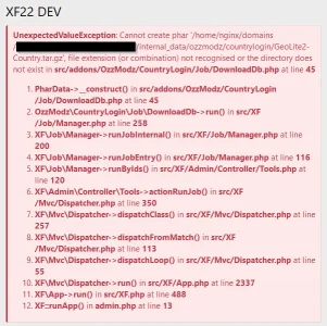

  1. The addon couldn't create the /internal_data/ozzmods/countrylogin/ directory for some reason, so I had to manually create it and set the appropriate permissions.
  2. I created a key and selected No when asked if it would be used with GeoIP Update.
  3. I downloaded the .mmdb file by going to https://download.maxmind.com/app/geoip_download?edition_id=GeoLite2-Country&license_key={key}&suffix=tar.gz, replacing {key} with my key.
  4. I extracted and uploaded the .mmdb file to /internal_data/ozzmods/countrylogin/.
I can't remember if I set the key in the addon options after step 2 or after step 4.
I copied the list of 2-digit country codes from here, pasted it into the addon options, and removed the ones I don't want to watch.
