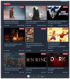

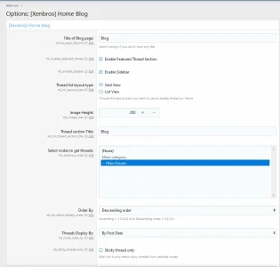

Here's what it looks like to add a topic to one of the grids. You need to open a topic, click the button to recommend a topic and you choose where to post - slide or grid. If there is a picture, it will automatically pick it up and the path, if not, you write the path yourself. My correction, I wrote above, corrects the output of this button. Because when you install the plugin on XF 2.2 +, this button no. My fix returns it. The rest of the plugin works properly.
Ah, I understand now. So basically when you write an article, you need to manually click the "Featured" button in order for it to show on the grid. It works, but it's a shame that there isn't an option to do it automatically.
That's right. However, if the button is not pressed, then the created topic in the desired forum will simply be published in order with all in the general list.

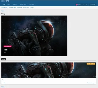

You can choose to display general articles by numbering or scrolling will open everything as you scroll down. There is a choice of that here.
The grids here are for articles that you specifically want to select as favorites for long publication. The purpose of manual addition is this. On WP this is displayed automatically, but you can set it to manual as well, so I don't consider this a disadvantage. Why would you want to publish everything in the grid if you don't need to? I think it makes sense.

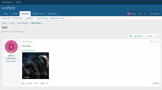

I have tried Sado's fix, but I cannot get featured post functionality to display any kind of button on my install of 2.2.1. The add-on does work otherwise, but I have no ability to mark a post as featured. No way to mark a post as featured when composing one.
Documentation of this add-on is non-existent outside of this thread. I am not happy at this point. As Sado warned in previous pages, I would not recommend purchasing this for XF 2.2.x until @hemant_bhardwaj can update it. Unfortunate, because it was very promising.
Personally checked on a clean install 2.2.4 and made changes to the template modifier, which is here pointed out and everything works.

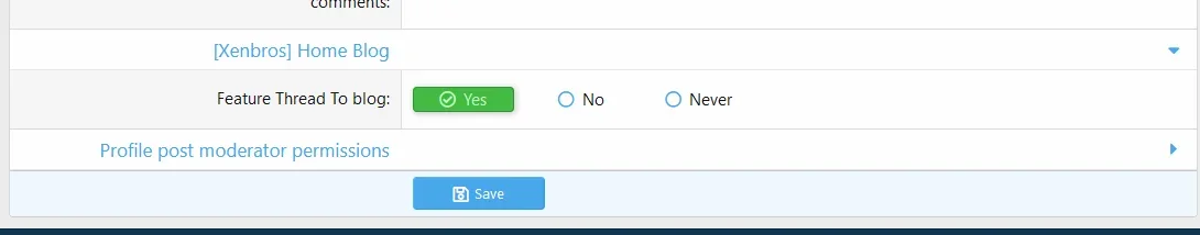

Did you enable visibility in user groups? If you do not include, then of course do not see the button.

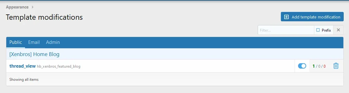

And yes, I apologize. The code changed with the last update. Last post doesn't work anymore. Here is the new fix.
New fix:​
Go to Template modifications - [Xenbros] Home Blog: thread_view - hb_xenbros_featured_blog
The "find" window:
Insert this
                        <xf:if is="$thread.canApproveUnapprove() AND $thread.discussion_state == 'moderated'">
                            <xf:button href="{{ link('threads/approve', $thread) }}" class="button--link" overlay="true">
                                {{ phrase('approve') }}
                            </xf:button>
                        </xf:if>
The "replace" window:
Insert this
$0
<xf:if contentcheck="true">
    <xf:contentcheck>
        <xf:if is="in_array($thread.node_id, $xf.options.where_show_feature_hb) && {{ $xf.visitor->hasPermission('xb_home_blog', 'xb_feature_thread') }}">
            <xf:button href="{{ link('threads/HBThreadEdit', $thread) }}"
                     data-xf-click="overlay">
                <xf:if is="{$HBblog}">
                    <i class="fa--xf far fa-bullhorn fa-fw"></i> {{ phrase('xv_hb_unfeatured_thread') }}
                <xf:else />
                    <i class="fa--xf far fa-bullhorn fa-fw"></i> {{ phrase('xv_hb_featured_thread') }}
                </xf:if>
            </xf:button>
        </xf:if>
    </xf:contentcheck>
</xf:if>
The button "Feature" for grid publishing will be returned to XF 2.2+

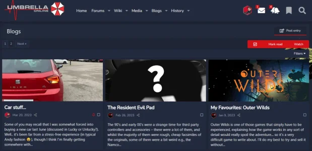

Hello all,
Looking into getting this to have a blog section set-up on our forums.
Apologies for the likely very basic question (I'm new to all this) is it possible to have this plug-in setup the thumbnails on a separately created page within Xenforo rather than the home landing page?

Hi
About the pages, definitely not. When you choose from which forums to display a topic, the thumbnail will automatically be loaded from the selected forums with the title of the topic and the name of the forum. If you have not uploaded anything in the attachment, it will not upload anything except the header and an empty window.
On the other hand, here you need to create a template modifier, so that the news output block template, duplicated in other pages you created. If I understand the question correctly. I can hardly help, you have to try.
