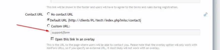

I've played with the options, changed the contact url settings several times and at once i got this errormessage
I can't remove this setting anymore=>
I've activated the custom url option, removed support/form and then set "default url" again...
I've tried to remove the support/forum value from the page sourcecode but nothing helped.. :/
Each time when i try to save the options, i get the Array to string conversion
The problem is the update query from the dw
$this->_newData[$tableName] is
and because option_value is a array, the query doesn't work, but WHY the hell is it an array and how could i fix this (except to try to overwrite it in the database or use the option datawriter)
