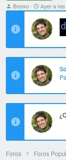

Hi, previously at XF1 notices rotated randomly?
Just one each X seconds was shown.
Is it possible to do so at XF2?
Now I have 3 notices with the same Criteria and all of them show at the same time (which needs lot of space on the screen).
Thanks!
