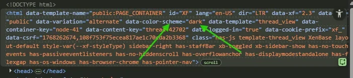

I did some testing before I wrote that all out, and found:
@media (prefers-color-scheme: dark) -- Works only when someone lets their system (OS) select dark/light.

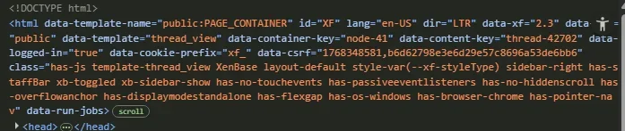

[data-color-scheme="dark"] -- Works only when someone directly chooses dark/light in the forum. Note that this appears in <html> only when someone selects dark/light in the forum, but doesn't appear when someone selects "system".
When I switch to system, notice how data-color-scheme is missing:
So that is why I included both. The @media version use the words "prefers" which tends to make me believe the user preference (in the system, aka OS) is being used. And indeed that proved out in my testing. I revised my test CSS for use in extra.less in the Bolt theme. It now uses four different colors, and it demonstrates how these particular selectors work.
