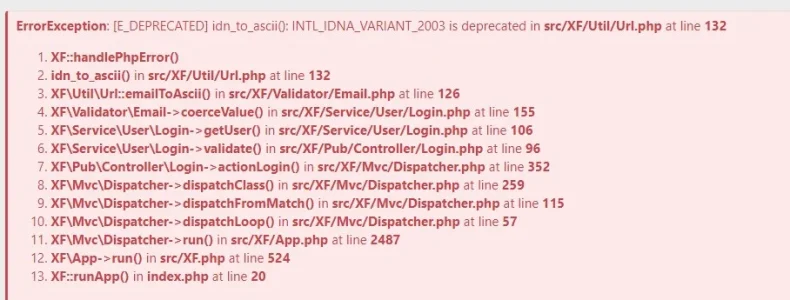

XF 2.2 No admin control panel access
Has the PHP version recently changed?
What version of XF are you running?
Are you able to downgrade PHP to 8.0 or 7.4?
According to /install you're running 2.2.13.
If this issue started without making any changes then it has to be something server side, such as the PHP version.
Deprecation errors should only be triggered with debug mode enabled, so it's worth trying to disable that if you have it enabled. Otherwise you might try to enable the intl PHP extension if it is disabled, or disable it if it is enabled. We don't pass any explicit flags to idn_to_ascii, and our polyfill should set the default appropriately so it's a bit puzzling why this would occur.
Thank you. We deleted some things from the server today regarding an old Word Press site, but it was located in a different directory. Coincidence? We did submit a support ticket to XF, as I forgot we had paid for support.
I was able to disable debug in config.php and now I have admin panel access.
Ah, it looks like this would only happen on PHP 7.2/7.3 with debug mode enabled. The default variant was deprecated in PHP 7.2 but not changed until PHP 7.4. I'll make adjustments to use the new default explicitly in future versions.
