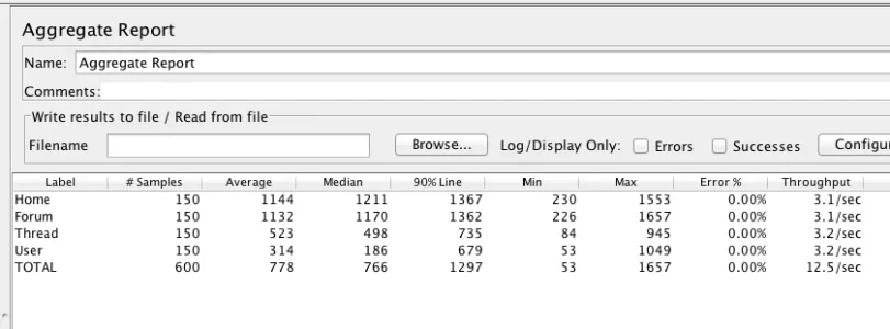

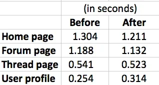

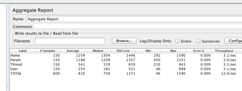

These are the details for the test. From there you can read that, for example, the Home Page went from a best scenario of 292 ms to 230 ms, and from an average of 1259 to 1144
The throughput of the server was increased by roughly 0.1%, which means that you would be able to serve 0.1% more requests with this change.
Templates from database
Templates from files
