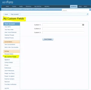

Right now we have 3 locations to show custom user fields:
  • Personal Details
  • Contact Details
  • Preferences

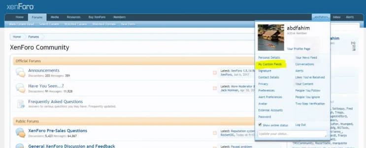

I want to add another location, say "My Custom Fields" and add that section in the settings page. Also, would like to have a link to that page in the profile drop down.

account_wrapper - To add a link to your new page in the sidebar.
navigation_visitor_tab - To add a link to the popup when you hover over your username.

I have done it! Now I have all my custom fields (that has display location = Personal) in a new page http://yourxfinstall.com/account/custom-field.

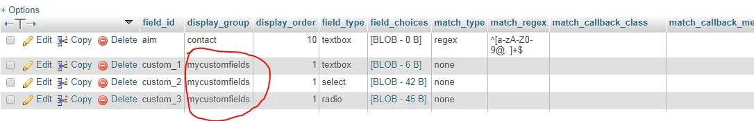

Or, is it okay if I manually change the value of display_group in the xf_user_field database table to "mycustomfields" for my intended custom fields:
UPDATE xf_user_field SET display_group = 'mycustomfields' WHERE field_id IN ('custom_1', 'custom_2', 'custom_3')

This is how I would've done it. It won't have any implications.

I am facing slight issues with my addon. The display_group of a custom field is not showing the changed value as in database:
In Forum:
