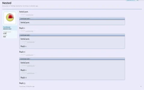

On my site, having done what was said above, here basically what a chain looks like:
CoreIssue said:
Initial post​
--- merged: A moment ago ---
Reply 1​
Reply 2​
Reply 3
You see some posting examples of a dozen or more Nested Posts to say do not allow. In years of using them rarely has that been a problem. Not to mention there should be an Admin Panel control to set a depth limit that meets the needs of each forum.
So, everyone can be happy if Admins are given the ability to choose setting for their own needs. Because some do not like them does not mean no one should be able to use them.
I hope that helps give a clearer picture.
