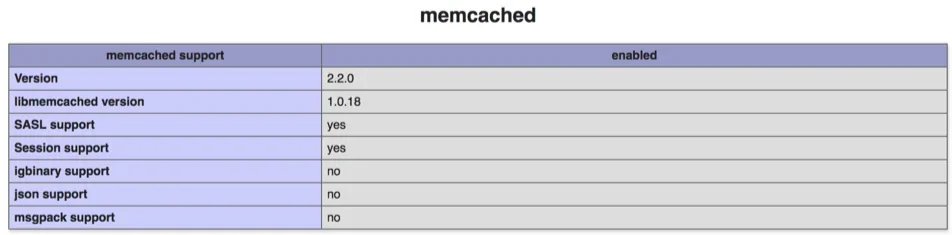

I am pretty sure that the extension should be memcached and not just memcache in the phpinfo page. It should also reference libmemcached in the phpinfo (my phpinfo section on memcached below):
I now have both loaded. Does Memcached need the SASL support enabled?
How do I ensure it's working correctly? I am still getting pages that error out when trying to load, but then they load automatically. It's strange. This is intermittent.
Also, I have another small forum site on the same server running XF 1.5 and I tried adding the same caching code to that config file and I get 503 errors when trying to load that forum.
