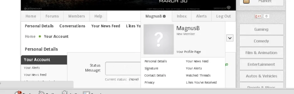

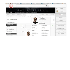

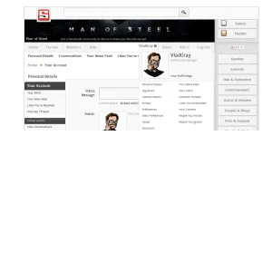

It is s very specific problem. I have this issue only with a profile tab, inbox & alerts tab.
As you can see on a screen below:
(First 2 pieces - main page, 2 others - profile , inbox & alert pages)
On a main page (index.php) everything looks ok, but when im switching to the tabs i ve mentioned, style is broken. Everything looks not as i wish it 2 look. Probably its a problem with these properties:
.Popup .PopupControl.PopupOpen,
.Popup.PopupContainerControl.PopupOpen
What i need, its just to correct tab styles on each page. However, if you do smth with properties eg padding margin etc, it may correct profile tab, inbox & alerts tab but will broke the index.php page tabs style.
Could you give a lil tip how to fix this issue.
Thank you.

Which browser are you using? For me, it displays absolutely correctly now, though there seems to be an issue with the drop down positioning, but it corrects it self when it is finished:

I'm using a big bro, Chrome. Yup the issue definitely also somewhere else out of the

I ve done everything like you said, triple checked it. All tabs looks as they must look, however (>xD) the profile tab is only the one who don't care (its not going out of its own nest, even more now its trying to be tiny as hell, all other tabs on all pages are on their places) about my changes:
I would give to it a custom image like this for its own mind lol:
Yay :D prob i ve solved the issue. A few more addition changes required. You ve mentioned about doubled -1 margin properties, need to change it also.
