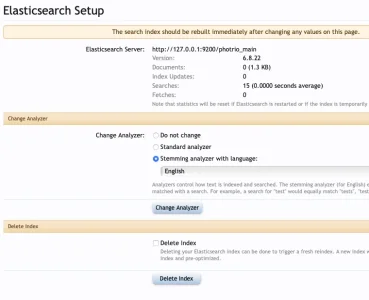

ok it was enabled and elastisearch installed a while back. I tried re-installing. I have this on my config page:
Am I missing something? Database is still blowing up at 28gb and rising. How do I stop it using xf_search without disabling all search functions?

maybe es is not even running on my server at the moment, i tried starting/stopping it the way I used to and got no response. is there an easy way to tell if it's running? whm server with ssh access
Ok after some help from Andy, got my elastisearch index built again and in settings elastisearch is enabled. I emptied my xf_search table after this which grew to 35 GB. I was hoping after enhanced search rebuilt that the xf_search would remain empty. Or does it not remain empty? It's already grown to 1 GB and seems to still be growing. With elastisearch running and selected, why is xf_search still growing? Thanks

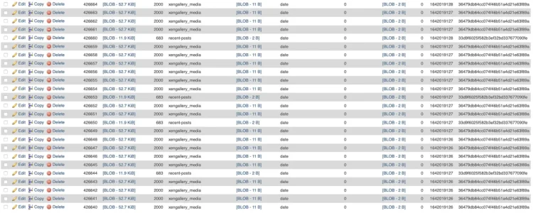

My xf_search_index is only 5kb but my xf_search is growing without stopping, it gained 25 GB overnight while I slept and is still growing. It is flooded with xengallery media inserts. My gallery is not THAT busy, so maybe a ddos or some glitch in the gallery hitting endless searches? If anyone has any ideas how I can track it down let me know. I'll check web logs and see if I can find a rogue ip hitting the gallery. @AndyB as well
Here is a screenshot of most recent inserts
ok that was useless, the only thing that stopped it was disabling access to the gallery for unregistered, but the bot is still hammering /forum/find-new which is recent posts and new posts, so that is filling up my xf_search as well and almost acting like a DDoS, ugh
