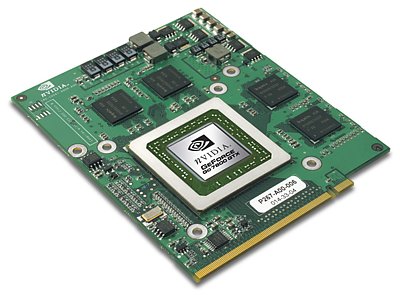

If you have a battery installed, remove it and try booting up with only power from the wall. A bad battery can cause this sort of problem.
You can't test the graphics card by plugging in an external monitor since you'd have to change your display settings in order to turn it on. You may also have a removal graphics card since it's an MSI(as long as it's not onboard).
