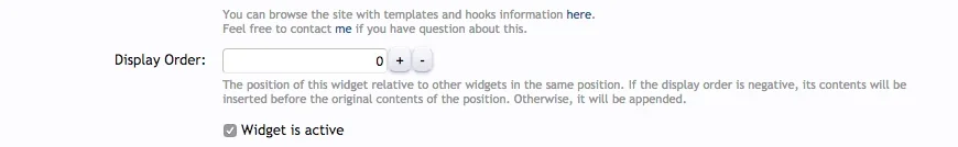

If you are talking about Widget Framework itself, the problem is a lack of reading in the discussion forum for that add-on AND a lack of looking very closely at the widgets one creates upon your part. There's this amazing little segment each time you create one that looks similar to this:
Oh, look... it says Display Order... and the description below it lets you know that it is relative to the other widgets in same position (forum_list, etc). So, the lower the number, the nearer the top they are.
If you are referring to standard sidebar widgets, then yes, you will need to edit templates (and also for any add-ons that create sidebar widgets).
