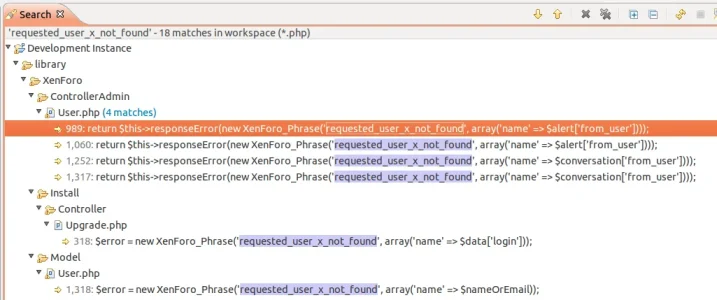

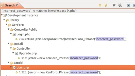

Is it possible to modify built-in phrases via an add-on?
I'm trying to modify the requested_user_x_not_found and incorrect_password phrases but it's not working.
I also tried searching the templates but can't find them referred to anywhere, does anybody know where I might find them?
